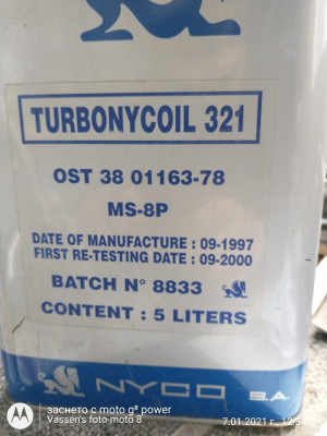

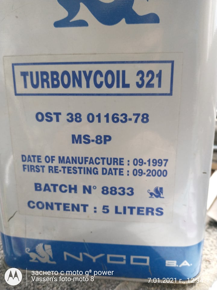

Шегувам се Пламене. Маслото е за турбовитлови самолетни двигатели, френско е, и е от Луфтханзата. За това е към теб се обърнах.
А това с морската почивка е супер, браво.
- Мнения: 13128
Re: Масло за двигателя
Ам че то минерално.
Mineral lubricating oil (Analog MS-8P/MK-8P) OST 38 01163-78
Petroleum lubricating oil, aircraft turbine engines. Turbonycoil 321 is based on a petroleum base stock and contains additives to improve the high temperature oxidation stability and prevent wear of gas turbine engines. It has a viscosity of 8 cSt at 50°C. It has been designed for the lubrication of the majority of gas turbines of Russian design. and also be used as an anti-corrosion oil in closed circuit (MS-8RK).
It has been used during 1990's on civil airliners such as Tu-134, Tu-154 and Il-76 with hundreds of thousand flying hours accumulated. Approval by Central Institute of Aircraft engines as an analog to the Russian type MS-8P and OEM Mashproekt approval for usng on industrial & marine gas turbines. It can be available in different quamtity. Our well expert sales team will provide you more technical specification of the product upon your enquiry.
- Мнения: 10866
